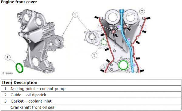

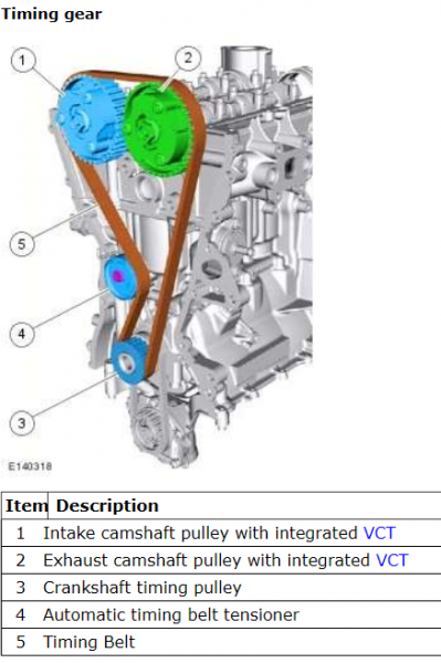

Esatto, quella che si vede nell'immagine è la pompa dell'olio a portata variabile con la sua cinghia di collegamento, la distribuzione è subito sopra:
Questo invece è il coperchio della distribuzione, comprende anche le staffe ed il condotto per la pompa dell'acqua:
Questa è la descrizione data dalla Ford:
A newly developed oil bath timing belt drive is used to drive the camshafts.
Advantages of oil bath timing belt drive over an oil lubricated chain drive:
Reduced frictional losses (about 20 per cent), thereby lower fuel consumption and thus reduced CO2 (carbon dioxide) emission
Reduction in noise The guide rails usual with chain drive are eliminated
The timing belt is tensioned using an automatic timing belt tensioner.
Advantages of oil bath timing belt drive over a comparable dry timing belt drive: The timing belt is maintenance-free (change 240,000 km or at the latest after 10 years)
The aluminum timing cover seals the camshaft drive to the outside. The lower area accepts the crankshaft oil seal which is installed from the outside. The special tools intended for the purpose must be used to remove and install the O-ring seal (see current workshop literature). The seal to the engine is made using a sealing compound (arrows). The oil dipstick guide is secured to the inside of the timing cover with three bolts. In addition, the timing cover contains the jacking point for the coolant pump. To be able to remove it, the coolant pump must first be detached.
